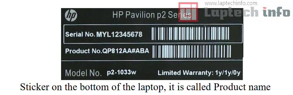

Brand and Model Number:
Identifying the correct laptop brand, series, model number, screen size and resolution is essential to finding the correct part for your laptop. The laptop series is typically more prominently displayed as part of the branding of your laptop, typically on the top cover, or on the keyboard area or display panel area of your laptop when you open it up.

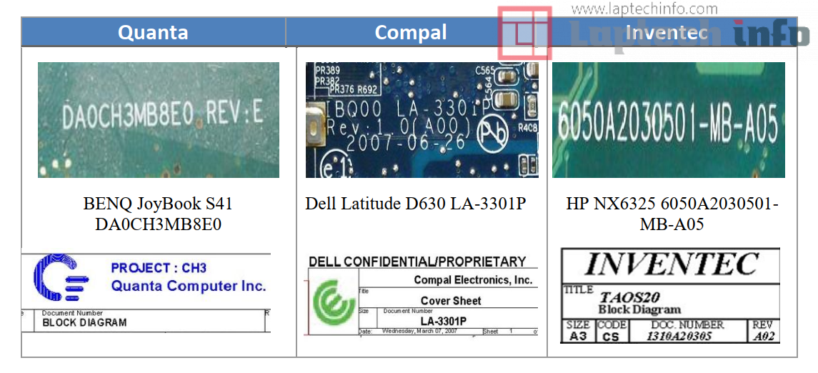

OEM Laptop motherboard:
OEM
or original equipment manufacturer, all branded laptop computer like Apple, Acer, Dell, HP, Lenovo and etc, they are not manufacture their laptop motherboard. All of them are using the third party company design laptop motherboard to build their own brand laptop.
The popular OEM Company is Compal, QUANTA, Wistron, Inventec and Pegatron.
These OEM Company have a huge market percentage on production of laptop motherboard.
The second line OEM manufacturer like: MITAC, Clevo, FIC, MSI, ECS, Flextronics, Foxconn, Topstar and etc.
List of some OEM (Original Equipment Manufacturers)
Quanta are probably the biggest laptop manufacturer, followed by Compal and Pegatron. Compal and Pegatron probably have the best quality overall. Information about the manufacturer and motherboard model laptop very important to us, you might need to know model number motherboard’s model for a number of reasons as stated below:

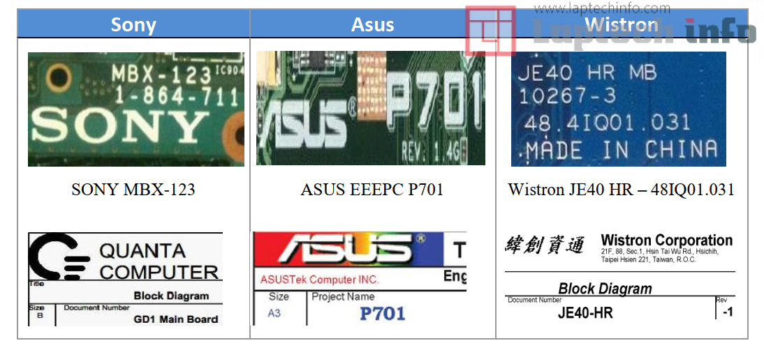

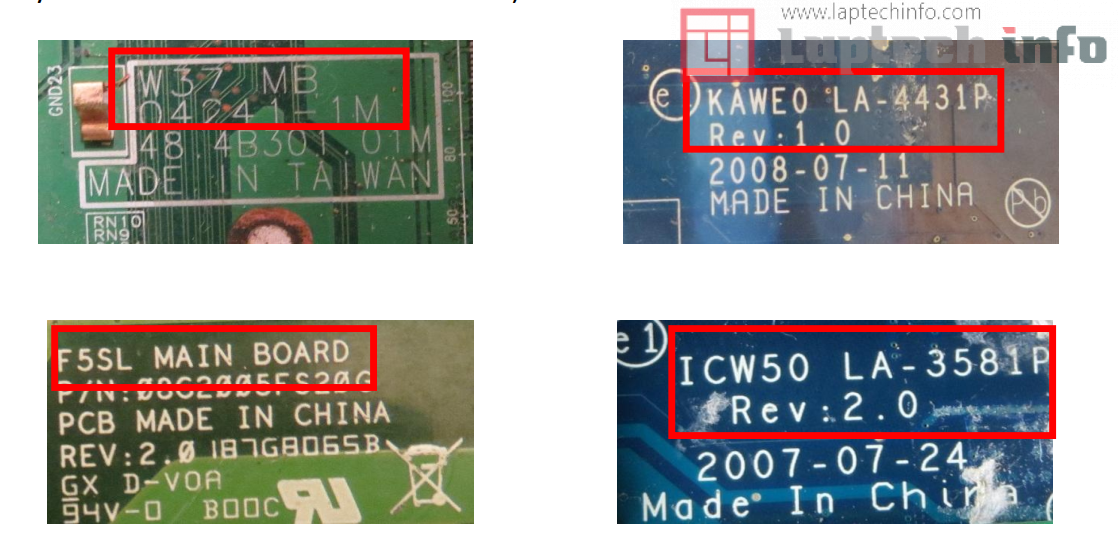

The easiest way to look for the schematic diagram in the internet is by using the laptop reference, for example: Acer Aspire 1300, Hp pavilion DV5-1000us etc. In case you don't find the schematic using the laptop reference you can use the ODM. To look for the motherboard schematic using the ODM method look for a reference printed in the motherboard and use it to search for the schematic, below is an example of those references for ODMs
Find the Motherboard ODMs (Original Equipment Manufacturer)​
This is usually printed on the motherboard, but can be located in several possible locations, for example, it may be printed near the RAM slots, near the CPU socket, or between the PCI slots. There will be a lot of writing on the motherboard, but the model number is usually written in the largest text (Motherboard model numbers are typically a collection of numbers and letters).

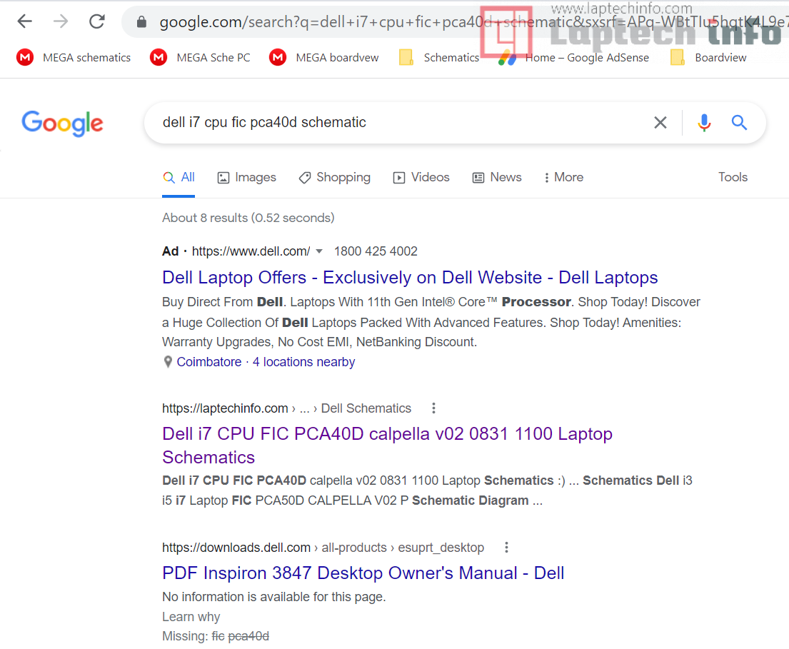

Look for your motherboard schematic online:​
Go to a search engine of your choice (Google) then type in your model number (ODM) followed by the word "Schematic or Diagram" and press entre, this will bring up a list of matching schematic motherboard models.
Carefully review the search results. Watch in particular for results in PDF format, as most manufacturers that do list their schematics online will do so in PDF (Adobe Acrobat) format.

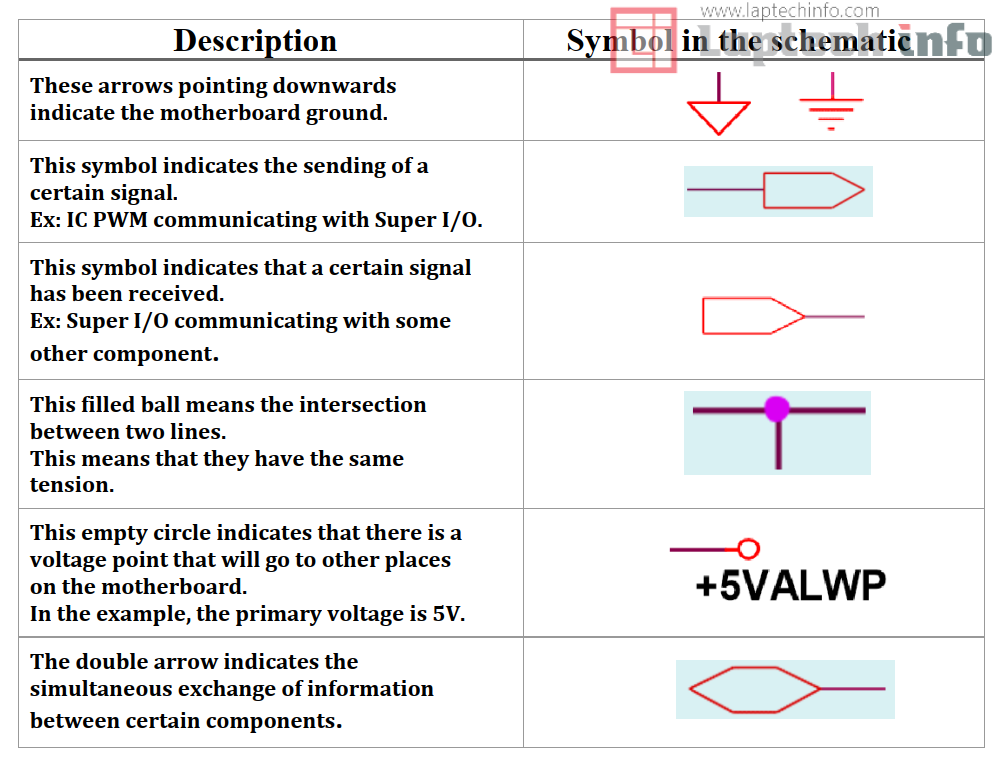

Symbol and Screen Printing:
One of the main problems faced by those who begin to read electrical schematics is the identification of components and also of symbol.
The various letters and symbols (which may even vary according to the design they are applied to) sometimes become one of the biggest difficulties that technicians usually face when repairing their first laptops.

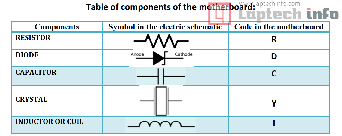

Every laptop motherboard is manufactured with letters on its surface that are located next to each component or region of a circuit, and that allow the technician to quickly identify what that component is about. They call it motherboard screen printing.
If you take a motherboard from a laptop you will notice that in addition to the description of the motherboard model, all components, be it resistor, diode, etc., have an identification that serves to help locate them in the wiring diagram.
Each component name found on the motherboard wiring diagram and screen must be unique. Ex: capacitor C1, C2, C3 and so on.
The following tables list some the main components used on a laptop's motherboard:
Just as screen printing is important for the motherboard, the symbol is for the electrical schematic.
Below are the main symbols used in the schematics of laptop:
