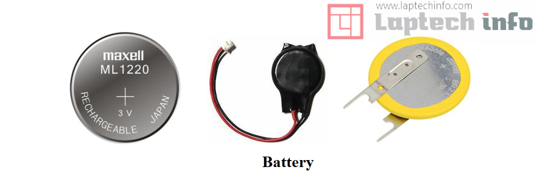

There are three types of CMOS based on the interface used to connect with a laptop motherboard.
1- Socket/button Type (Hand removable).
2- Connector Type (unpluggable removable).
3- Solder Type (De-solder the pin to remove battery)
Since the battery has one positive (+) side and one negative (-) side, you need to be sure that you are connecting the battery correctly

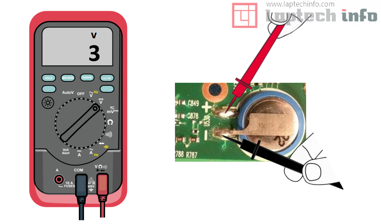

Testing the CMOS in a good condition or not. You measure it; if the CMOS voltage is 3V then CMOS is ok. If the voltage drops between 1v-0v then CMOS is not worth wearing.
