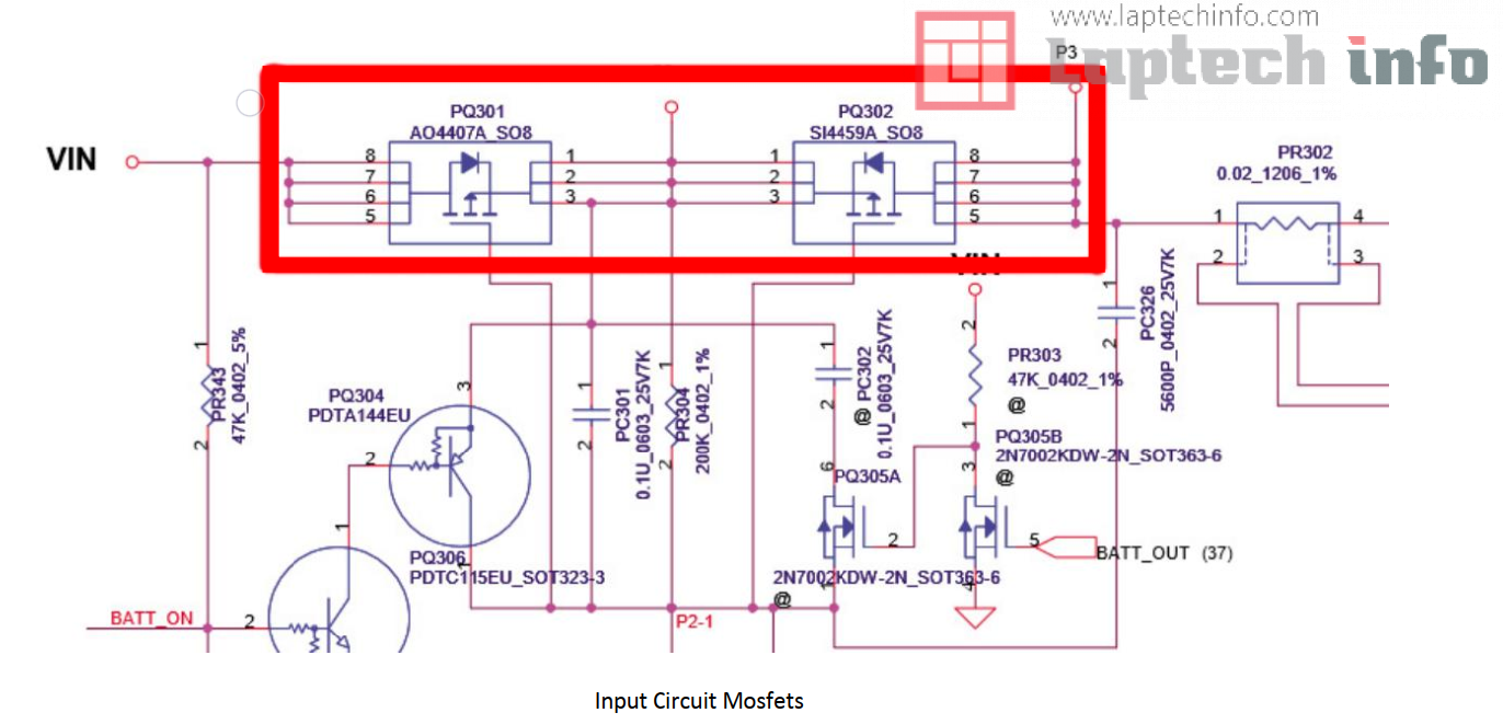

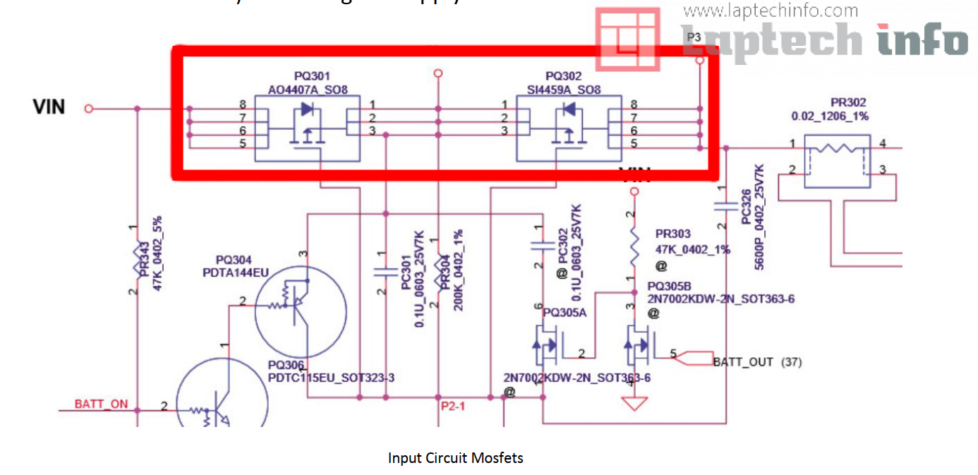

On 99% of the laptop motherboard there are two Mosfets (marked in red in photo below) that are in the input circuit, they are responsible for switching (passing from one side to the other) this voltage to supply the other circuits.
Well, for that to happen there is a more detailed process. However, you now need to understand the basis of how the input circuit works.

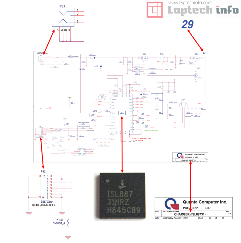

Through the schematic diagram in page 29 (charger IC), there is an information about Power Jack and Battery. Circuit charger is a main gate power regulation sourced of battery and adaptor.
Sometimes people confused how to find about "where is the Power IC in a laptop? ", because IC charging 3V and 5V, VCC core is an IC too. With the different function and ways is working, so where is a correct IC power? In this page, I will explained with a simple description about basic of that circuit.

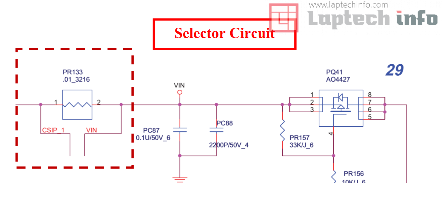

Voltage from DC Jack with P11 that sourced from adaptor entered into PC85 and PC84 are arranged in parallel which works as noose filter with the term voltage VA then enter to PL6 and after through PL6 it changed name to VA1. PL6 function is temporary saving a charge. If we add a fuse in this circuit before the voltage entered to PL6 maybe will be good, but we see another component diode after PL6 that protect and block reverse flow so a problem adding fuse will be solved. And other that, diode function for eliminate AC voltage from inductor.
Conclusion of the figure is voltage name 19V (it depend on laptop adaptor 19V-20v-18,5V, etc) will be changed when entered a component or circuit one and the other.
DC# is command sign from EC from page 27 schematic, signal from EC will command P-channel gate to open gate if there a problem at circuit. This is called a Circuit Protection and in upper level will cooperate with selector circuit.
Circuit works as a control or signaling technique as the detector whether the voltage comes from an adapter or a battery or even both of them for the charging system.

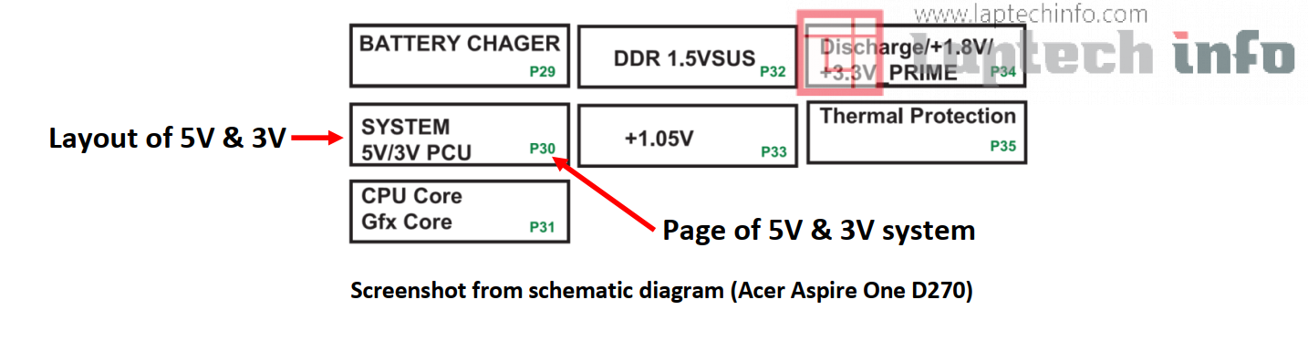

If we want to find the layout of 3V and 5V systems in the schematic diagram on the first page there is a schematic diagram of the system description 5V/3V PCU, then open the pages. In this case there is on page 30, below an example.
From a page 30 you know information of the type of IC used and the circuit contained in the page and Project Description / Name Circuit.

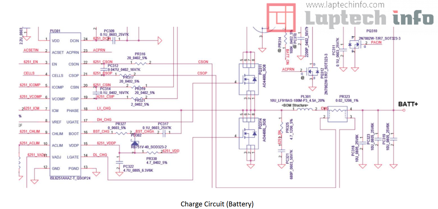

Battery charging circuit (charge) is responsible for recognizing and charging the battery. It is the one that controls the power supply to the motherboard when the charger is not connected.
In photo, the charge circuit is basically formed by the IC PU301, by a high Mosfet (PQ311), a low Mosfet (PQ314) and an inductor (PL301).
It is in the charge circuit that we find the famous MOSFET SWITCH, which switches the voltage of the battery and that of the charger, making sure that they do not collide.
The operation of the switch Mosfet is very simple. Imagine that you have a laptop connected with a charger and battery connected, at that moment the battery is in the background being charged and the charger is feeding the entire motherboard. If you remove the charger, the laptop will continue to be powered by the battery voltage thanks to the switch Mosfet.
Tip 1: Cases such as when the laptop works only on the charger or only on the battery is a strong indication of a defect in the switch mosfet. Sometimes the battery may stop charging and the defect is in the Charge circuit and not in the battery itself.

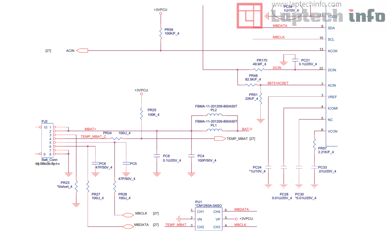

Tip 2: Another tip of the charge circuit is to check the battery connector (with it connected to the motherboard), if the voltage is present (usually 12V). In the example in Figure 8, it can be checked at terminal 1.
