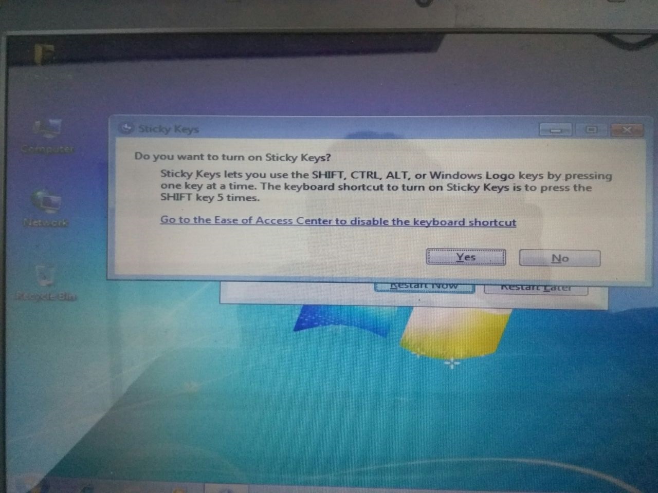

The Samsung NP-RV511 model laptop got weird issue.
Case: the laptop operating system boots in normally, after boot up the windows 7 the operating systems pops up a window says "Do you want to turn on Sticky Keys?"
so i have detached / removed the keyboard from motherboard and then tired, the issue not solved. removed touch pad, the issue still exists. reinstalled Windows 7 again still same issue. When i click folders or files it selects like we are holing Shift key on keyboard.
Sollution: The problem fixed by reprogramming the BIOS, after flashing the bios file, the Sticky key problem is solved.
